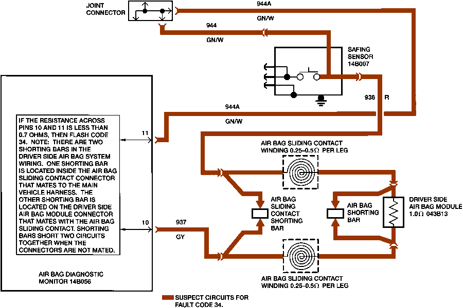

Pinpoint Tests -- Air Bag System
DRIVER SIDE AIR BAG MODULE CIRCUIT LOW RESISTANCE OR SHORTED FAULT CODE 34
Normal Operation
The air bag diagnostic monitor measures the resistance across pin 10 (circuit 937 "GY") and pin 11 (circuit 944A "GN/W") every time the ignition switch is turned to the ON position. Normal resistance across these circuits is between 1.5 ohms and 2.0 ohms. This resistance comes from the air bag module itself (approximately 1.0 ohm) and the air bag sliding contact windings (approximately 0.25 ohms to 0.5 ohms per winding, two windings in all) and the safing sensor (approximately 0.2 ohms). If the resistance across these three circuits is less than 0.7 ohms, the air bag diagnostic monitor will flash a code 34 on the air bag warning indicator.

Electrical Schematic -- Driver Side Air Bag Module Circuit Low Resistance or Shorted Fault Code 34
Pinpoint Test -- Driver Side Air Bag Module Circuit Low Resistance or Shorted Fault Code 34
- 34-1: VERIFY CONDITION- Key ON.
- Count the fault code (if any).
- Is code 34 flashing?
- Yes
- No- READ the Normal Operation Description for this fault code. EXAMINE the fault code schematic and look for areas where intermittent problems would occur (connectors, splices, crimps, etc.). DO NOT PROCEED WITH PINPOINT TESTS UNTIL THE CODE IS FLASHING! FAILURE TO DO SO WILL RESULT IN NEEDLESS REPLACEMENT OF THE AIR BAG DIAGNOSTIC MONITOR AND REPEAT REPAIRS.
- 34-2: CHECK AIR BAG CIRCUIT- Deactivate the air bag system - leave the driver side air bag module connector disconnected (do not install Rotunda Air Bag Simulator 105-00009).
- Disconnect the air bag diagnostic monitor connectors.
- Measure the resistance across Pin 11 (circuit 944A "GN/W") and Pin 10 (circuit 937 "GY") at the black air bag diagnostic monitor harness connector.
- Is the resistance across Pins 10 and 11 infinite (open)?
- 34-3: CHECK FOR SHORT IN AIR BAG MODULE- Install Rotunda Air Bag Simulator 105-00009 onto the air bag sliding contact connector at the steering wheel.
- Reconnect the air bag diagnostic monitor connectors.
- Turn the key from off to ON.
- Wait 30 seconds.
- Yes- REPLACE the air bag diagnostic monitor. VERIFY the system. REACTIVATE the system.
- No- EXAMINE the shorting bar on the driver side air bag module connector for proper function. (EXAMINE the air bag sliding contact-to-main harness connector as an example of a normal shorting bar.) REPLACE the driver side air bag module if the shorting bar is normal. VERIFY the system. REACTIVATE the system.
- 34-4: CHECK FOR SHORT IN AIR BAG SLIDING CONTACT- Disconnect the air bag sliding contact connector at the base of the steering column where it mates with the main vehicle harness.
- Yes- EXAMINE the shorting bar in the air bag sliding contact-to-main harness connector for proper function. (EXAMINE the driver side air bag module connector as an example of a normal shorting bar.) REPLACE the air bag sliding contact if the shorting bar is normal. VERIFY the system. REACTIVATE the system.
- No- LOCATE and SERVICE the short across circuits 944A and 937 in the wiring harness. INSPECT the air bag diagnostic monitor harness connector and the air bag sliding contact harness connector for shorted terminals. VERIFY the system. REACTIVATE the system.
